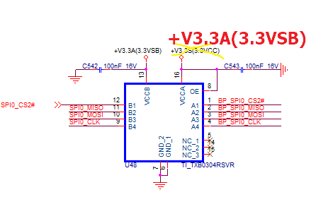

We have a motherboard (CPU: Intel Core i5-1335UE) that uses the TXB0304RSVR as a level shifter to convert SPI from 3.3V standby power (3.3VSB) to SPI 3.3V main power (3.3VCC).
However, we’ve encountered an issue with this configuration.
Schematic:
When the ATX power pulls PSON# low to turn on the system, the TXB0304RSVR's OE pin is high, which causes interference to the SPI source (3.3VSB). As a result, the BIOS flash is affected and the system fails to boot.

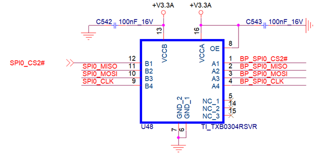

In our experiment, if we connect both the VCCA and OE pins to 3.3VSB (Circuit shown below), the system is able to boot normally.
(Note: During the failure, the connector had no device attached — meaning the A-side SPI lines are floating.)

  • You do not need a level shifter when you do not want to shift levels. And the auto-bidirectional architecture of the TXB (which never allows an I/O pin to float but forces it to either high or low) is likely to interfere with other signals on the bus when OE is high during power on.
    Please specify exactly how the MISO signal should behave. If it is shared between multiple SPI devices, then it must be disabled when the SPI slave is not being accessed. So you need a three-state buffer like the SN74LV125A (controlled with /CS), or an analog switch like the SN74CBTLV3126/TMUX1511.

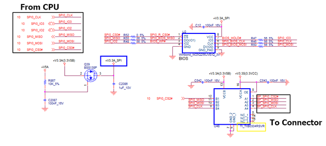

    We are considering using the following circuit to strengthen the SPI signals in our board:
    Circuit:
    Would this configuration be suitable?
    If not, do you have any recommended ICs for this purpose?
    Thanks.
  • The TXB has a drive strength of 20 µA; it will not strengthen but weaken the signals.
    An analog switch will not buffer the signals. Use a buffer like the SN74LV125A (powered by either 3.3VCC or 3.3VSB); it will isolate the two sides, even when powered off. The MISO signal must be disabled with the /CS2 signal. (Any input pin that might be disconnected must have a pull-up or -down resistor to prevent it from floating.)
