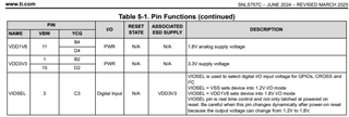

hello,I would like to ask a few questions about the TUSB2E221 chip. One is whether the pull-up voltage of EQ is 1V8 or 3V3,; the other question is whether it is NC or other connection method when 1-channel USB is not in use
The voltage used for the I/O can be set by the VIOSEL pin on the TUSB2E221. It can be either 1.2V or 1.8V:
If only one channel is being used, I would recommend leaving the unused channel floating.
