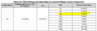

I have interfaced ADS131M04 evem board with MCU and i am using internal oscillator of Freq 8.192Mhz for ADS131 board (Pin1-2 shorted on JP6).
I want to keep 16ksps sampling rate with power mode as HR, Clock configuration done for HR power mode, with OSR 256, this verified by reading back clock reg value i.e 0xF06

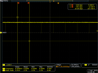

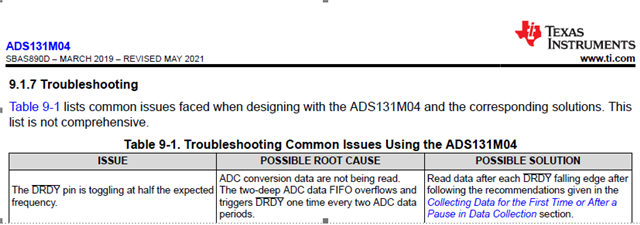

but when i check the timing of DRDY pin transition from High to Low I get 125uS which is almost 8ksps. Anything else we need to configure for sampling rate configuration?
Also the output data rate mentioned in datasheet is for 1 channel or considering all 4 channel?
