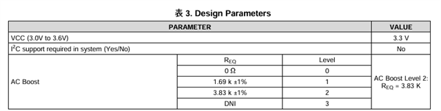

when adjusting the EQ value to Level 1, is it necessary to use a resistor value of 1.69kΩ only, or is there a range of resistor values that can be used?

Hi Sky:
For level 1 EQ, Req around 1.7k should be fine.
