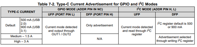

    2. Is the current mode detection (via OUT1/OUT2) only available when operating as a UFP? Will there be no output on OUT1/OUT2 when acting as a DFP?
    When configured as a DFP, these pins will have no output. There will only be output on these pins when set as a UFP, correct.

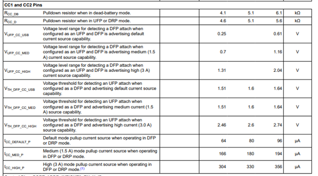

    3. How is the advertised current determined — by the internal Rp or Rd resistors? In DFP mode, is it possible to advertise 1.5 A or 3 A current levels?
    The advertised current is determined by the voltage level seen on the CC lines when set as a UFP:
    When set as a DFP, current advertisement can be done, but only via I2C. The TUSB321 should allow this via GPIO.

    Based on my current design (DRP, GPIO mode), is it correct that the maximum advertised charging current is limited to 900 mA when acting as a power source (DFP)? Is it possible to advertise a higher current in this configuration?
  • Hi Kent,
    1. If a DRP smartphone is connected, will the TUSB320L continuously switch between DFP and UFP roles, or will it eventually stabilize?
    Also, is it true that the final stable role after each connection could randomly be either DFP or UFP?
    If both are DRP, yes, it should eventually stabilize. However, which role both the devices take will be totally random. There are ways you can try to bias which role the TUSB320 will take when set as a DRP if you are using I2C, via the DRP_DITY_CYCLE bit of register 0x09. However, if you stick to DRP, there will be no way to change this, it will stay random.
    There is no way to change this in GPIO mode. The TUSB321 however does have this ability in GPIO mode, if that would work better for you: https://www.ti.com/product/TUSB321AI
