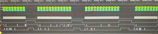

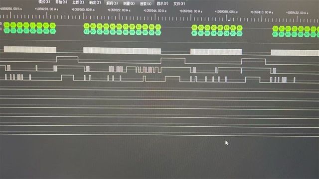

    They could receive correct right data if they just use the receive function, the SPI result is as below:
    However, they receive a wrong data if they use TCAN45550-Q1 to send a data:
    The sending ID is 0x100,sending data is 0x00000100000000
    The received wrong data is 0x215,the data is 0xFFFFFF9F00000000
    Jack
  • Hi Jack,
    I'm not really sure what you are trying to show me with the SPI plots, but I do see some potential errors.  The 4th byte transmitted is the "Length" field which is the number of data "words" that will be transmitted or received in this SPI transaction.  Each data word is 4-bytes or 32-bits and this tells the device how many SPI bits and SPI clock cycles it should expect while the Chip Select signal is low.
    A single register read is a total of 64 SPI clock cycles or bits.  The first 32 are from the Header which contains the Read/write Op Code (0x41 or 0x61) followed by the address and the Length byte.  If Length =0x01, then there will be an additional 32 SPI clock cycles or bits transferred while Chip Select is Low.
    If Length = 0x02, then there will be a total of 96 SPI clock cycles (32 from the header, and 64 from the data).
    If Length = 0x03, then there will be a total of 128 SPI clock cycles (32 from the header, and 96 from the data).
    I see in their plots that the chip select stays low for a time period corresponding to Length = 0x01.  Sometimes they correctly set Length = 0x01, and sometimes it is incorrect with 0x02 or 0x08.
    I don't know how they are setting the Length field in their SPI Driver code, but it appears it may have an error and this may or may not be a reason for their other errors.
    Another possible reason is an MRAM allocation error where they have overlapped element times (such as RX FIFO buffer elements with TX Buffer elements causing data to overwrite itself resulting in unexpected data transmission or reception.  I would suggest they also review their MRAM configuration to make sure there are no overlapping elements.
    Jonathan

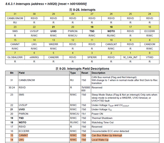

    Thanks for your kindly response, my customer wonder the way of wake-up, I think we just need wo read the bit14/bit15 of h0820, right?
    Jack
  • Jack,
    Yes, to check the source of the wake-up that occurs on the TCAN4550-Q1, the CANINT and LWU bits can be read through SPI.

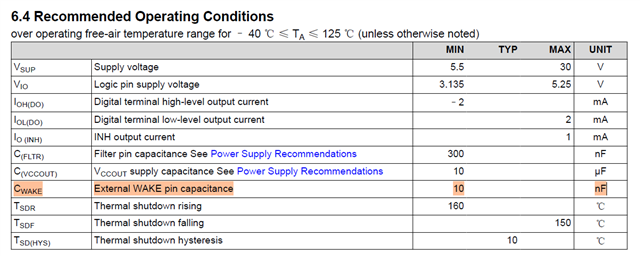

  • Hi Eric,

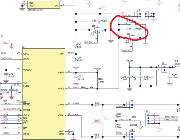

    We notice that the Cwake need to be greater than 10nF in Datasheet, but we just use a 100pF in EVM, is there any wrong?
    Recommend Cwake in Datasheet:
    The EVM schematic is as below:
    Jack Li
  • Hi Jack,
    The purpose of the cap is to stabilize the voltage on the pin to avoid false transient switching and false wake events.  A real application in a vehicle is more likely to see this type of transient noise and the EVM is used in a lab environment where this noise is not present.  The EVM board is just an evaluation platform and may or may not have all the components, or components with the required values, that is suitable for all applications.
    The datasheet recommends 10nF for an application.  The datasheet also states that if the WAKE pin is not used that it can be directly connected to either GND or VSUP which would mean that a 10nF cap is not required.  So the customer will need to determine the appropriate value cap and pin configuration for their application.

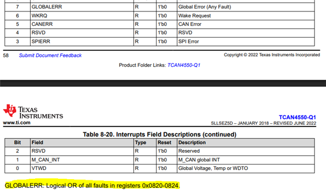

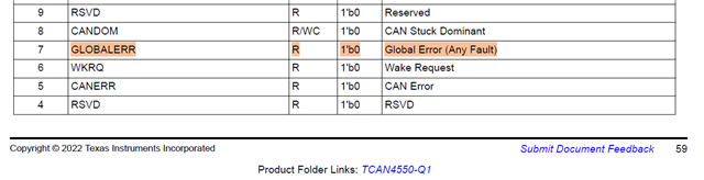

    What does the GLOBALERR bit means? could you please help to clarify it, thanks.
    Jack
  • Hi Jack,
    Please see the note at the bottom of the table.
    This bit is set when any other interrupt bit is set and allows for a single bit to be monitored as an indication that one or more other interrupt bits have been set in either register 0x0820 or 0x0824/0x1050.
