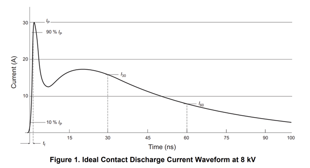

I'm looking for the unencrypted spice model for the tvs3301 diode. Would like to use it in a simulation for an ESD protection circuit that I'm working on.
Also, I am testing to 61000-4-2 HBM (150pF, 330 ohm) with the cap charged to 15,999 volts. I see that the TVS3301 says it's rated up to 30kV for this standard for both direct contact and air discharge. I would then assume that for my test this device alone would be adequate to absorb the energy and clamp the voltage spike. I would think that an extra resistor to absorb any of the excess energy would not be needed. Is my understanding correct ?
