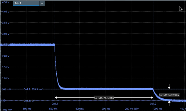

I'm using a PHY [DP83867IRRGZT] on a board I designed, but during shutdown sequence checks it is behaving differently than expected, violating the FPGA shutdown sequence, so I'm looking for a way to improve this.
After powering on the system and establishing Ethernet communication, when powering off the system, the 2.5V voltage supplied to the PHY remains at 500mV for approximately 750ms, then discharges to 0mV over 100ms.
If Ethernet communication is not established, the voltage does not remain at 500mV, and immediately discharges to 0mV.
The PHY is operating with a dual power supply configuration (1.0V, 2.5V) and the VDDIO-Supply supplies 1.8V.

I will post the captured waveform.
Is this a characteristic of the PHY?

  • Hi Kato-san,
    I just measured this in our EVM and this is an expected behavior of the PHY when there is MDI link and the 2.5V goes down.
    This will not damage the PHY and is an expected behavior of the PHY.
    J

    Is there any way to improve this shutdown sequence?
    2.5V is used as the FPGA bank power supply voltage,
    which would significantly violate the FPGA shutdown sequence.

  • Hi Kato-san,
    Unfortunately, the MDI link is backpowerinh 2.5V so the only way to improve this would be to unplug the ethernet cable.
