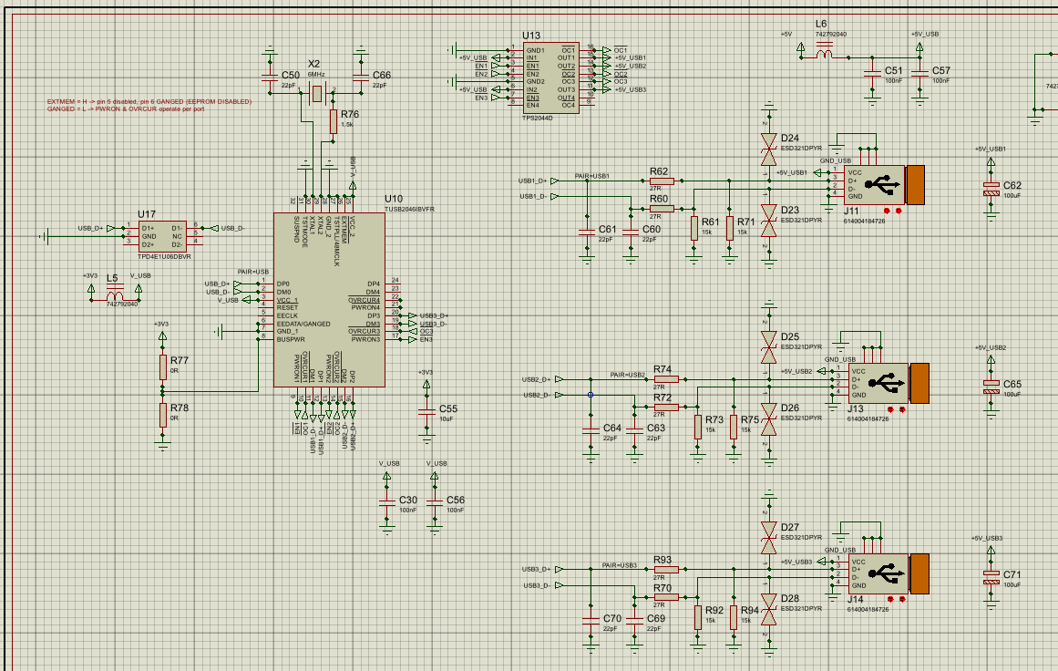

I'm developing an electronic board with a raspberry pi CM4. As, this one has only one USB port, I've put an USB hub (TUSB2046) on my board (you can find my schematic below).

         Does CM4 has hub driver?
         from schematic, need 1.5k pullup on DP0.
       Also need 22ohm resistor on DP0/DM0.

    Thank you for your suggestion, and I just check the datasheet and effectively on the figure 11, these two elements are suggested. I'll try it.

  • where did you add 1.5k? It should be on DP0 and pull up  to 3.3v.
    Best
    brian
  • Yes, it's what I do.
  • Do you have 22 ohm series resistor on DP0/DM0? Can you plug you board with hub  to any Windows PC and see TUSB2046 is detected  on USBtreeviewer or device manager?

    Yes, I have put the two 22 ohm resistors on DP0/DM0. I've tried to connect my board on my computer and nothing happens.
    I have measured the voltage on one USB port (+5.0V), and as soon as I plug my mouse, the voltage goes down to something between 0.5 to 0.7V.
    The voltage is set by the TPS2044D. I've checked EN1 and OC1.

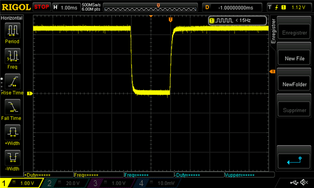

    I've also noticed something else. When I start my board, the USB voltage (measured on the 100µF capacitor) is +5V. But if I wait a few minutes, this one is going down slowly. After 5 minutes, the voltage is @ 4.6V power supply voltage on TPS2044 is @ 4.995V and it doesn't change). Maybe, the problem is with the TPS2044.

    Edit : I just noticed that my crystal starts to oscillate and after a few seconds, it stops.

    - The USB hub has four ports but I only used three of them, does I need to connect the fourth port to my TPS2044 ?
    - My 5V on my USB connector is OK (When I plug my mouse, the voltage stays at 5V, so no problem), but the little LED under my mouse doesn't work, so I think communication between hub and mouse doesn't work.
    I've put a pull-up of 10k on each OCx input (even if the input is not used), and I have link all PWRON input with the TPS2044.
    I've checked the order of connections to be sure (+5/D-/D+/0V).
    Concerning the BUSPWR pin, I don't understand how I must connect it. I want that my board supplies the USB slaves, but I don't really understand which mode is self bus powered or bus powered ?

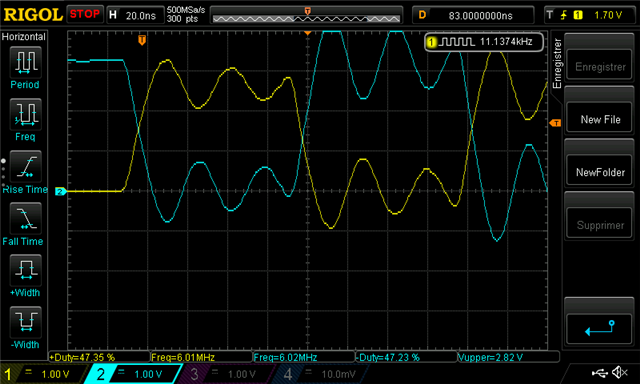

    - upstream port (very weird - but hub is recognized by cm4):
