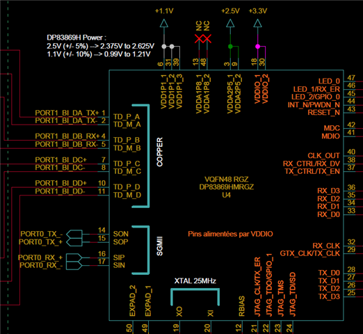

  • Hi Pascal,
    Would you mind sending us the schematic? I sent a friendship request so please accept and feel free to send via message.
    I am asking for one because SFP modules are typically routed onto the fiber pins of DP83869. However, for DP83869, fiber and SGMII pins are shared so it would be impossible to be routed onto the same pins. This may be the case in which you routed SFP module to the copper MDI pins that the PHY may not be detecting the link status properly causing the link status to show as down but is able to transmit/receive data.
    J
  • Hi J,
    Here is how the SFP module is routed, we use it for optical SFP module or RJ45 SFP module, just switching the configuration beetween "1000M Media Convertor Mode" and "SGMII-to-Copper Ethernet Mode" :
    Pascal

    Interesting. Is the link status properly reflected in 1000M media convertor mode?
    Also, SGMII and fiber pins are shared. In this schematic, it looks like the SGMII pins are only routed to the SFP module. Are the SGMII signals routed separately or do you intend to send SGMII signals onto SFP module also?
    Is port 0 a regular RJ45 port?
    Also, in this case, C00h and C01h may be able to indicate link status as those registers are supposed to be used to tell your link status in fiber or media convertor mode.
    Please let me know.
    J
  • Hi J,
    Yes, when we are in “1000M media converter mode” with an optical SFP module, link status detection in register 0xC01 works correctly, but not when we are in “SGMII to copper Ethernet mode” with an RJ45 SFP module.
    P0 is the SGMII/fiber port to SFP (optical or copper SFP type) and P1 is the copper Ethernet port :
    Pascal

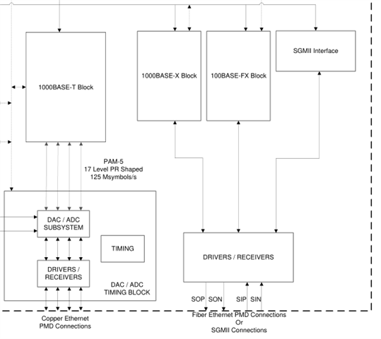

  • Hi Pascal,
    In SGMII to copper mode,  the link status will be determined from P1, and not P0. Even if you plug RJ45 SFP module into the P0, in SGMII to copper mode, the link status will be determined if auto-negotiation is done on P1.
    I am still having a hard time understanding how this connection is done for both SGMII to copper and media convertor. Would it be possible for you to provide us a block diagram of the system?
    Also, I know that the link status LED is low, but is the Link LED on P1 going high when the cable is connected?
    J
  • Hi J,
    Here is a block diagram of my system :
    It's true that the LEDs behave strangely. When I have a link only on the copper SFP port p0, the link LED of port p1 does not go high but the activity LED of p1 blinks.
    Pascal
  • Hi Pascal,
    Thank you for the block diagram. That helped with my understanding a lot.
    In SGMII to copper mode, Link status is determined by P1. So, if there is no connection on P1, the link status will not go high and the Link LED of P1 will not go high.
    However, you have both P0 and P1 connected, if I am understanding your problem correctly?
    What is the link partner? Is the link partner same for the media converter mode?
    Also, I understand that you are using the same board to achieve two different modes. If so, are you changing the strap configuration to change the PHY's operational mode, or are you changing the register configuration at the board initialization? If you use the register configuration, could you show us your register configuration?
    Lastly, is this the only board that happens, or are there multiple boards showing this behavior? And how replicable is this issue per board?
    Please let me know.
    J
