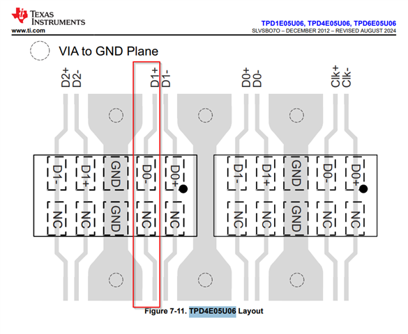

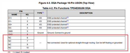

I am checking the layout recommendation:
It looks like the NC pin is connected to D1+, am I understand correct?

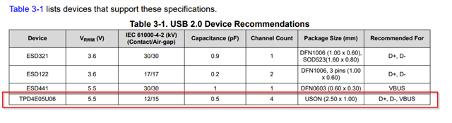

And additional question, can this D+ used to protect a power supply, such as VBUS:
Thanks for your support.
BTW, my previous design used with TPD4E004DRYR, is there any weakness if I move to TPD4E05U06? (for TYPE-C D+/D- protection)
