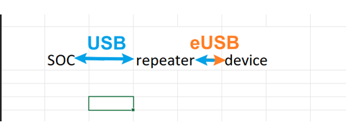

Can TUSB2E221 working reversely? where SOC has USB internface and far end has eUSB interface?

If the device is able to communicate with the TUSB2E221 and configure to device/peripheral mode, then yes this application would be viable.
This document has more information about different eUSB2 applications: https://www.ti.com/lit/ab/snla464/snla464.pdf?ts=1765988231725&ref_url=https%253A%252F%252Fwww.google.com%252F
