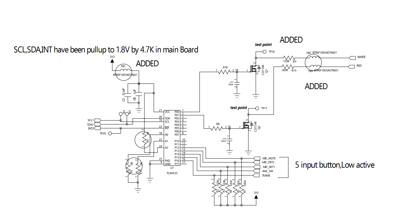

Hi ti team,
Please help check if the schematic diagram of TCA9535 is correct. Thanks!
  • Hi Switch,
    U7 - TCA9535
    Check
    Status?
    Comments
    Within Supply Voltage Range?
     Good
    PCA Devices - 2.3 V - 5.5 V
    TCA Devices - 1.65 V - 5.5 V
    TCAL Devices - 1.08 V - 3.6 V
    Local Decoupling Capacitors
    Good
    Generally, a 0.1-uF capacitor is placed on VCC, as close to the device as possible
    Verify the schematic pinout matches the data sheet pinout
    Good
    RGE
    Check that the pullup resistors are present on the SDA and SCL net within the schematic.
    Verify
    PU resistors are most likely in another page of the schematic
    Unused GPIO pins configured as INPUT’s are biased to either VCC or GND via resistor
    Verify
    Most of TI's IO expander portfolio do not include internal pull-up resistors on the p-port pins; the exceptions are PCF8575, PCF8574, PCF8574A, TCA9555|PCA9555, PCA9554|TCA9554, and TCA9554A|PCA9554A and therefore can be left floating.
    An alternative approach is after powering up the device, any unused p-port pins can be set as an output (does not matter if set high or low).
    TCAL agile IO expanders also have the ability to enable internal PU or PD resistors.
    GPIO pins configured to OUTPUT must be current limited externally
     Verify
    i.e. the push-pull output sources current from VCC or sinks current to GND. Ensure that the output is never tied directly to VCC, GND, or to another output that could contend with the push/pull output. Otherwise, IOH/IOL may not be limited and could exceed abs. max conditions of the device which could cause permanent damage.
    Device address is unique on the bus unless using an I2C switch or I2C MUX to resolve conflicts
    Good
    If the device has a /RESET pin, bias the pin high (preferably with a pull-up resistor) after powering up.
    n/a
    If the device has a /INT pin and the /INT pin is used, tie this pin to a pull-up resistor.
    Verify
    CHeck for PU resistor - /INT is open-drain output
    P12-P16
    Verify
    Is there some filter capacitance that can be added to help with debounce from the switches?
