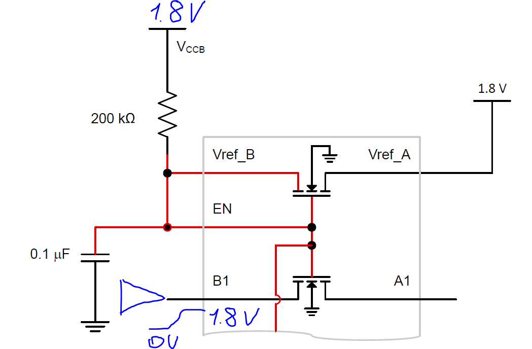

Hi.
We are using LSF0108-Q1 just as ON/OFF switch for QSPI 1.8V interface. Signals are driven by a push-pull drivers at 1.8V level. Expected output level after the LSF0108-Q1 switches need to be 0 - 1.8V levels as well. We want to make sure that we understand the datasheet correctly
  1. Assuming we are driving EN pin directly by a push-pull driver to drive the EN pin. Its voltage level to enable LSF0108-Q1 switch conduction state needs to be 2.6V (*1.8V + 0.8V) or higher, correct? Having EN pin voltage level reach only 1.8V will cause output clamping to about 1.2V, correct?
  2. Assuming the following implementation, voltage on A1 pin will not reach 1.8V unless a pull-up to 1.8V resistor on A1 is used, correct?
