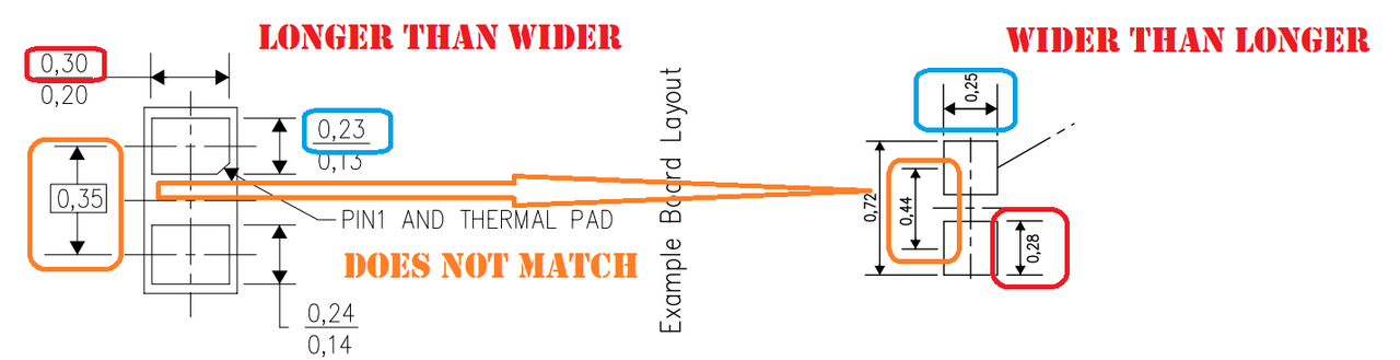

Part Number: ESD441
Can you please advise?
The pad doesn't match the actual component.
I want to use DPL which is X2SON package.
Part Number: ESD441
Hi Meital,
This is okay. The device still fits onto the land pattern. Please see image below.
McKenzie
