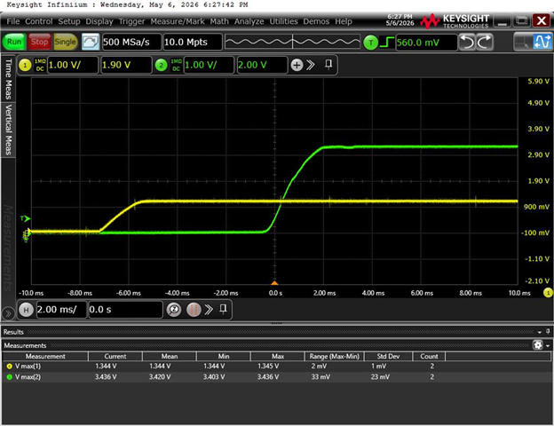

When P3V3_AUX is not ready,there is a leakage from VDD3. P3V3_AUX looks good when NOPOP L13USB3.Do you have any comments and suggestions?
Part Number: TUSB8042A

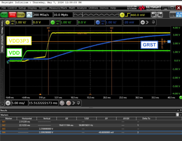

What’s the root cause? From the spec perspective, VDD should be powered up before VDD3P3.
There is Diode between VDD and VDD33, if VDD is up earlier than VDD33, there is current path from VDD to VDD33.
So it's prefer to power on VDD33 earlier than VDD and keep GRST low at least 3ms after both VDD33 and VDD stable .
