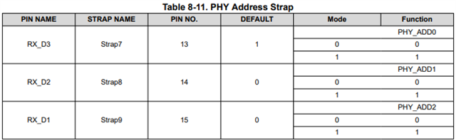

  • Hi Himanishu,
    The mdio_bus error suggests you are not getting register access to the PHY. We have a DP83826 troubleshooting guide with checks to perform to ensure the PHY is brought-up correctly. I strongly recommend reading through this document and looking for discrepancies in your design.
    The pin details suggest you're in RMII follower mode. I recommend comparing your schematic to our DP83826 schematic checklist to ensure all pins are implemented correctly.
    One thing I notice from your pin description is that RX_D3 is left NC. This pin is an internal pullup, which will strap this high on start. Since this is also a PHY address strap, you are strapping the PHY to address 001, not address 0. Can you try this and all other address options to see if you're targeting the wrong address?
    Shane
