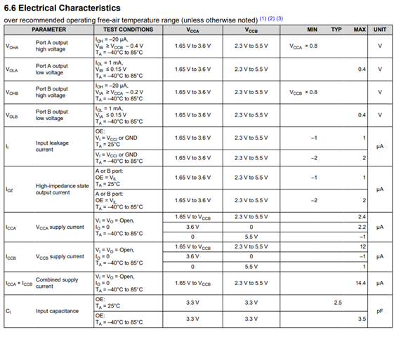

Dear TI experts,
My customer tests their own PCB which is used TXS0104ERTUR.
In the test they found that if OE is low, all outputs are high-impedance state, it is mentioned on the datasheet.
But actual measurement value is about 312.28Kohm.
Compared to other device, (NXS0104GU12X^NXP) is measured as open status.
So Do you have any range or minimum value of high-impedance state?
(i.e. if the resistance is higher than 300Kohm, it is high impedance state.)
Please check this issue. Thanks.
