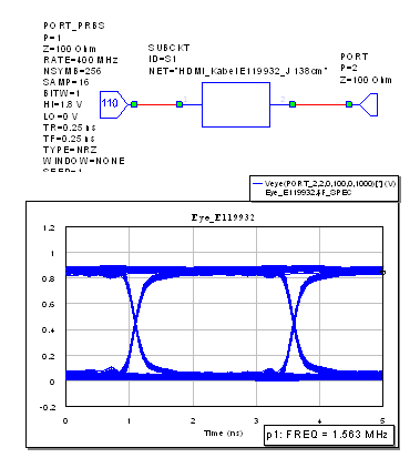

I've downloaded the IBIS Models of the serializer  DS92LV2411 and the deserializer DS92LV2412. We found out that the the serial input / output ports are not connected in the IBIS models.
Please send us a workaround to solve this problem! The serial input / outputs are the fastest interfaces and we are going to simulate the eye pattern!

  • The IBIS models for this device only model the signal integrity of the input and output ports, not the behaviour of the device.
  • This is exactly the point:  The eye pattern mentioned in my post shows the signal integrity (see the graphic below as an example). I'm not asking for a logical model of the device. Of course I would prefer the HSPICE model to calculate the signal integrity as we did in the past for more complex chips.
    The IBIS models 4760.DS92LV2411.ibs and 6064.DS92LV2412.ibs describe the signal behavior of the most input and output ports. But the serial ports are missing (see the part of the IBIS model I’ve copied). In both chips are the serial ports not connected and I’m going to ask you for an improved model
    [Pin] signal_name model_name R_pin L_pin C_pin
    1      DI22         I_DATA_SCR_HS50:  -> this port is connected to the description in the IBIS model
    19    DOUT-    NC                                   -> this port is not connected to the description in the IBIS model
