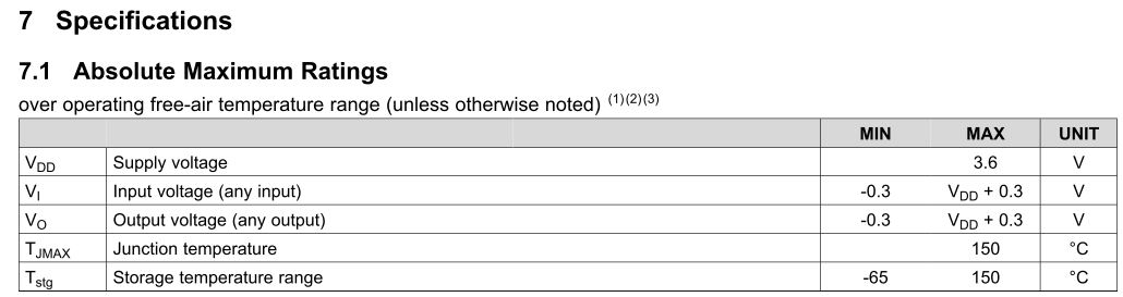

Please allow me to ask you about the SDA and SCL pin voltage when VDD is off, in case if there is an exception.
Our customer will use different power supply for LMH1983 VDD and pull up voltage for I2C bus lines. They will turn off LMH1983 VDD when the device is not used in their application to lower system power consumption. However, I2C pull up voltage would be kept on.
I believe absolute maximum ratings of SDA and SCL pins are also VDD+0.3V. So would it be not allowed to apply voltage to the SDA and SCL pins when VDD is OFF ?

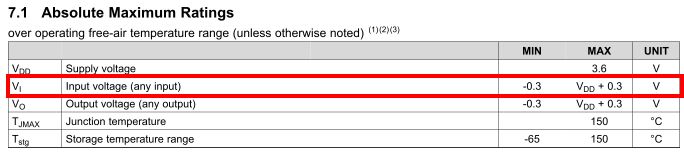

  • Kawai-San,
    SDA and SCL SMBus data and clock signals have open drain Input/Output structure. Since they are open drain or open collector, you can have some devices power off while others powered on. This will not cause a problem.
    Also, the ESD structure on these two pins are different from a regular input/output device. Therefore when one device is power off the other device that is powered on cannot forward bias the ESD diode on the device that is not power on.
    Regards,,nasser

    So, even if there is LMH1983, which does not have power supplied, connected to I2C bus, the other devices on the I2C bus could communicate correctly and LMH1983 would not have any damage. Am I correct ?
    I believe it would be better to have dedicated "Absolute maximum ratings" description for SDA and SCL pins, because, user would think VDD+0.3V would be the required spec as it says all input pins / output pins.
    Does SDA and SCL pins only have bottom side ESD protection diode ? What would be the absolute maximum rating for these pins ?

  • Kawai-San,
    1). Your understanding is correct. Powered LMH1983 devices can communicate using SMBus even when there are other un-powered LMH1983 devices.
    2). SCL and SDA are the only signals with bottom side ESD protection. Please refer to the data sheet for the absolute maximum ratings.
    Regards,,nasser
  • Hi Nasser-san,
    I greatly appreciate for your support. I am almost clear.
    What do you mean by refer to the data sheet for the absolute maximum ratings ?
    Regarding the absolute maximum rating specification in the data sheet, I thought there are top side ESD protection for SDA and SCL pins, too. What would be the absolute maximum ratings for these pins ? Is it 3.6V like VDD pin ?

  • Hi Kawai-San,
    Yes it is 3.6V for the absolute maximum rating on SDA and SCL pins.
