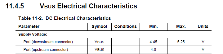

1. when they set the USB3.1 type C port loading is 3A, and measured the device(TPS65982) PP_5V0 voltage is about 5.12V, but the VBUS voltage is 4.987V, they want to why there is 0.133V voltage different? Is the 4.987V within the USB3.1 type C specification? Will this voltage drop affect the USB3.1 type C functionality?
2. from the USB3.1 type C specification viewpoint, when in the 5V/3A load operation, what’s the  min/typical/max voltage spec for VBUS?
