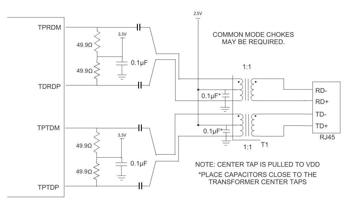

Hi team,
In my customer's application ckt, the TD pins of DP83849 are biased to 3.3V through 49.9R ressistor at device side, however on transformer side, which is located on another board and has been kept as is, the center tap of transformer is pulled to 2.5V. Can DP83848 work properly in this condition?
