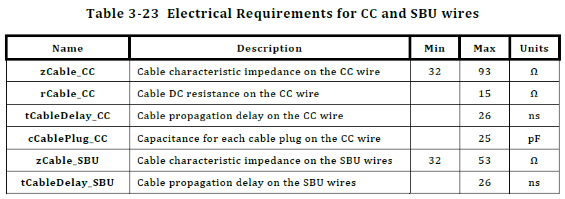

I need the information on following items.
  • Characteristics impedance of SBU1 and SBU2 signals
  • Characteristics impedance of CC1 and CC2 signals
  • Characteristics impedance of AUX_P and AUX_N signals
  • IO standards of all the above signals
