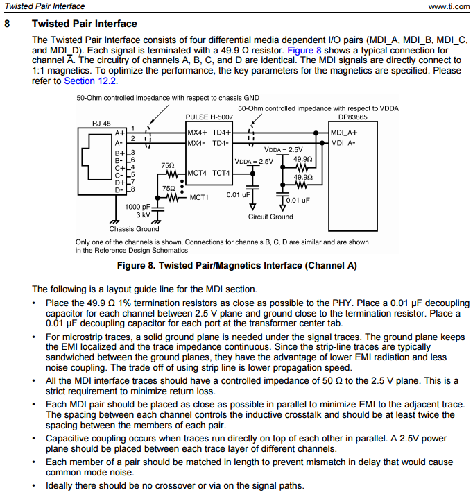

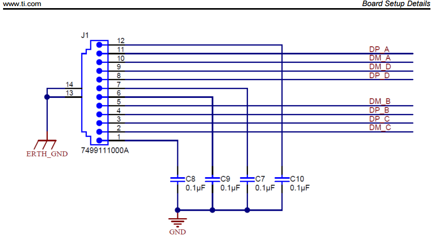

I would like to interface the DP83867IR with the following GbE transformer http://productfinder.pulseeng.com/products/datasheets/H5120NL.pdf. How should I connect the center tap pins on the transformer. I have seen on the eavaluation module that the center tap pins are connected in the following way.
In this application note for a different TI GbE PHY the center tap pins are connected in the following way with the center tap pins connected to 2.5V
Which is correct?
