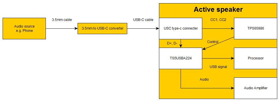

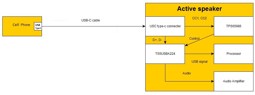

Dear Sir,
We're building a active speaker with USB type-c connector and choose TPS65986 as PD controller.
We would remove 3.5mm aux-in on our product and use USB type-c as audio input.
Can we achieve audio input as below? Seems that USB type only support audio out, not sure if we can do below as audio in.
Thanks.
Kane
