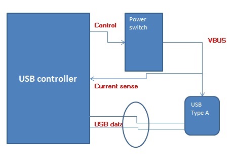

Hi Team,
I have a board that is being powered by standard 5V, Type-A USB. I would like to draw 1A from the USB connector. Is there a device I can place on my board to perform the negotiation to deliver 5V @ 1A to my board?
Thank you,
Jared
    You can't get 1A from a USB2.0 nor USB3.0 downstream port, what you can do is to modify the hardware of your Host board (the one that is providing the VBUS to your board) and make it not to monitor the current draw of the USB port, that way the power switch providing the VBUS will not be limited by the USB controller.
    Below picture show a typical USB implementation, chances are that your board that provides VBUS is configured that way, you will have to disconnect the "control" and the "current sense" lines in the below picture to do what I mentioned above.
    The other option is to use an external power supply in your board.

  • The USB device will tel to the Host controller how much power it needs, however the max current for a USB3.0 is 900mA, so there is no way to get 1A.
    The above solution is to prevent the USB controller to shut the device down when more current is drawn, the USB device will still be telling to the Controller to require 900mA, however you will be able to draw more current with an external power source when the USB controller is not in charge of the current draw monitoring.
    The implementation will be non-compliant with USB but you will still be able to draw 1A.
