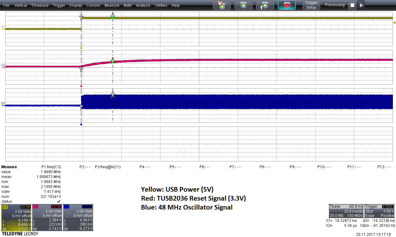

I need your help as I am not able to get the TUSB2036 device working at all. It gets not detected by any host PC (have tried Linux and Windows machines). It behaves like connecing a USB charger or power bank: Power gets supplied to the board but nothing else happens. The device seems to be hanging in its startup sequence as the DP0PUR pin never gets driven high. When patching the upstream D+ to 3.3V using a pull up the PC recognizes a full speed device, but fails to access the USB registers.

- Clock is 48 MHz and signal looks good. (See attached picure)
- Reset signal seems to be okay and asserts 50-100 ms after the clock starts (See attached picure)
