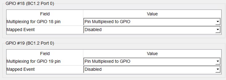

Part Number: TPS65987D
Hi, Team,
Could you teach us how to configure GPIO18/19 as BC1.2 by Applucation Custmization Tool? My customer is connecting GPIO18/19 to Type-C D+/D-.

Hi Yone-san,
It appears there may be a bug in our configuration tool. You should be able to select Pin Multiplexed to Alternate Function (BC1.2) from the multiplexing drop-down. However, that appears to not be working. I have submitted this bug report to our tool developer and we should have it resolved with our next tool release.
