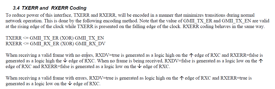

What are the valid voltage levels of RX_CTRL signal?
I see the following description in datasheet
"the received data available and receive error are combined(RXDV_ER) using both rising and falling edges of the receive clock(RX_CLK)"
I see 1.8v pulses and ~1v pulses on this pin. Does 1.8v pulses correspond to valid packets? Does 1v pulses mean RX_ER?
