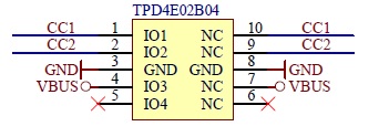

1) I come across a schematic where TPD4E02B04 is used for CC1, CC2 and VBUS protection.
Can be TPD4E02B04 used for CC and VBUS lines ?

    You cannot use TPD4E02B04 for CCx and VBUS as this device is only for 3.3V signals.
    You can use a bidirectional device on a unidirectional line but not the other way around. It is up to you on which device you want to use uni or bi but the TPD4E02B04 has very low capacitance that can support USB3.2 signals.
    The TPD4E02B04 can be used on USB2.0 but so can most of the ESD devices in our portfolio.
    For a TVS diode for VBUS we have TVS2200 for the 20 V VBUS applications and TVS0500 for the 5V applications.
