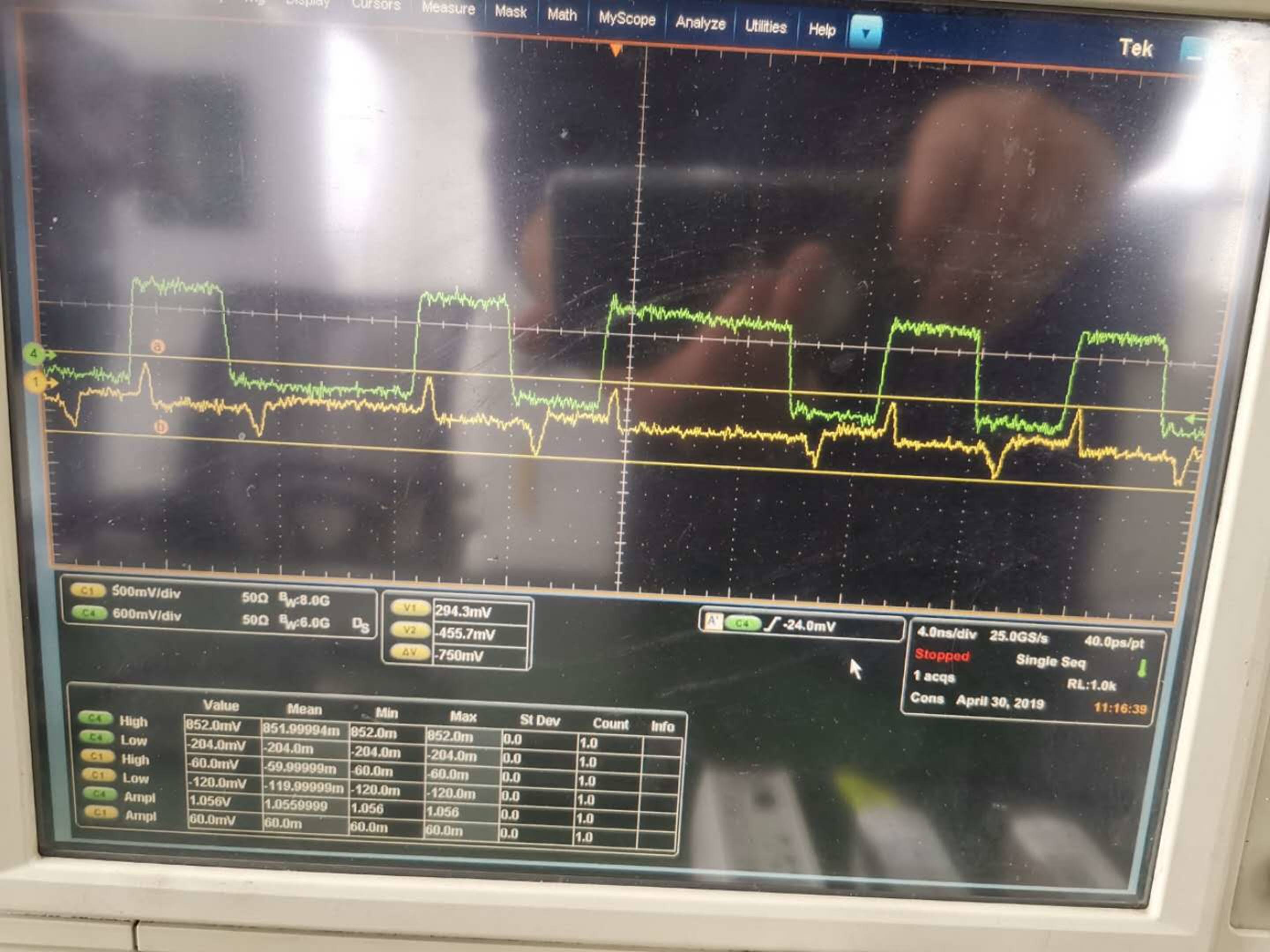

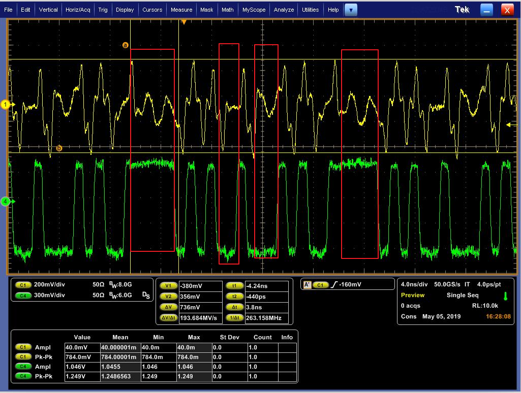

Dear all:
I connet 1Gbps input signal and I confige RATE=0,TXIDLEDO/SO =float or 0,SD_TH= float , FAN OUT =0, and I capture the wave at input and output, find  waves are abnormal , if there are continus high or low at input , the outputs are abnormal , and output waves have only a pluse wave at the edge of input , attach the wave ,green is the input and yellow is the output
