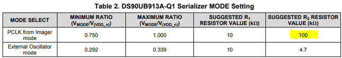

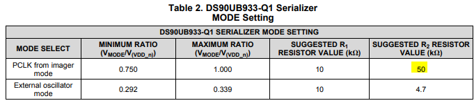

Hi team,
The suggested R2 resistor value is 50kohm for PCLK from imager mode of DS90UB933-Q1 Mode pin. However,  the suggested R2 is 100kohm for DS90UB913-Q1.
1) Could you tell me why the R2 resistor is different even the setting for RATIO is same between 933 and 913?
2) What the impact for system with using smaller R2 value?
