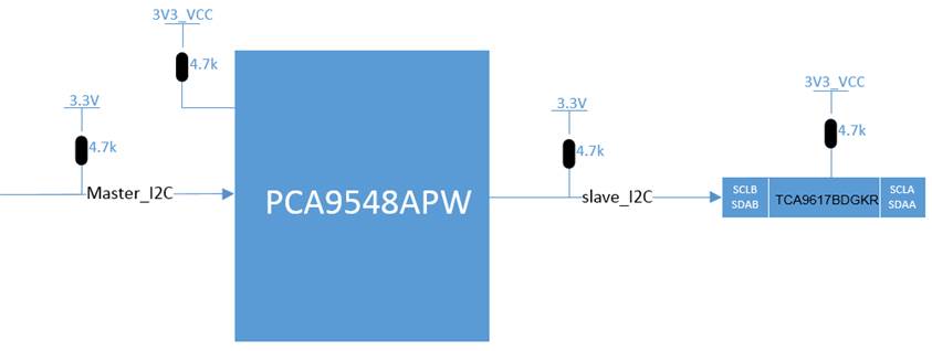

whether the structure below is ok or not. TCA9617's port B connect to PCA9548 , both are 3.3V,
What are the 9548/9617 port A/portB VIL/VIH/VOL/VOHdata? We cannot find all the information in the datasheet.
Thanks.

Hi Frank,
We are looking into this and will get back to you tomorrow away the latest.
