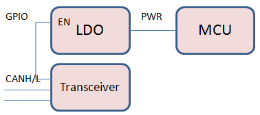

I have system quiescent current request. so need CAN tansceiver remote weakup and enable local LDO to deliver power for local MCU.
May I know TI has suitable CAN tansceiver? Thanks!

Yes, the TCAN1043-Q1 was designed for this purpose. You can use its INH output to control the EN input of a power regulator. An example of a typical application
using this connection is given in the datasheet.
Please let us know if you have any further questions.
