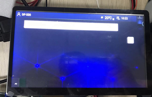

I use the DS90UB949 and DS90UB928 deivce, but I found the display is incomplete, as right side of below picture.
Could you please help to resolve it? Thanks a lot.

Hello Went,
Is the whole right half of the image missing or is only a small amount missing? Also what is the PCLK rate and video source?
Casey
Dear Casey
1. It is right half of the image missing.
2. PCLK is 74.25MHz, and the video source is 1280x720 HDMI.
Is there any register that control the video display ?
Went,
it is accurate only the left half is displayed in the panel?
if it is correct, I would concern if the video source has issue or not? pls measure the LVDS_CLK in ub928 side, is it 74.25MHz? If it is right, whether the panel has issue?
For TI's FPD-Link, it can't change the video output content.
