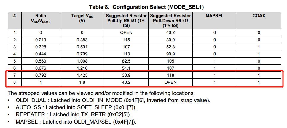

#7 and #8 have the same MAPSEL and COAX, is there any difference between them? #1, #3, #5 are also same.

Hello Sherry,
See this thread for info on the MODE_SEL1 settings: https://e2e.ti.com/support/interface/f/138/t/835069?tisearch=e2e-sitesearch&keymatch=ds90ub947%252525252525252520mode
Settings 2, 4, 6, and 8 also change the default register value for 0x54
