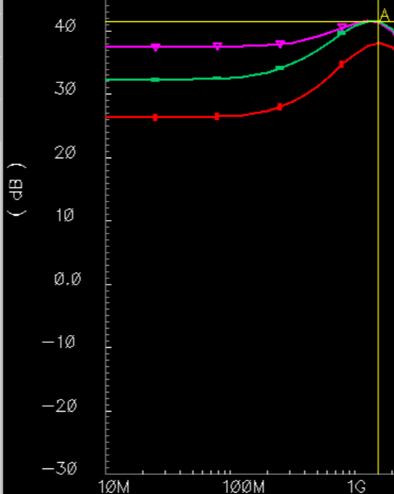

In order to simulate the effect of EQ, I'm looking for the Equalizer Response of DS25CP102.
Could you please provide the following information:
- Nb of poles
- DC gain
- Zero freq
- Pole 1 freq
- Pole 2 freq
Best regards

Unfortunately these equalizers were designed a long time ago. I do not have the original design information on the equalizer performance.
Here is a graphic which shows the frequency response.
Lee

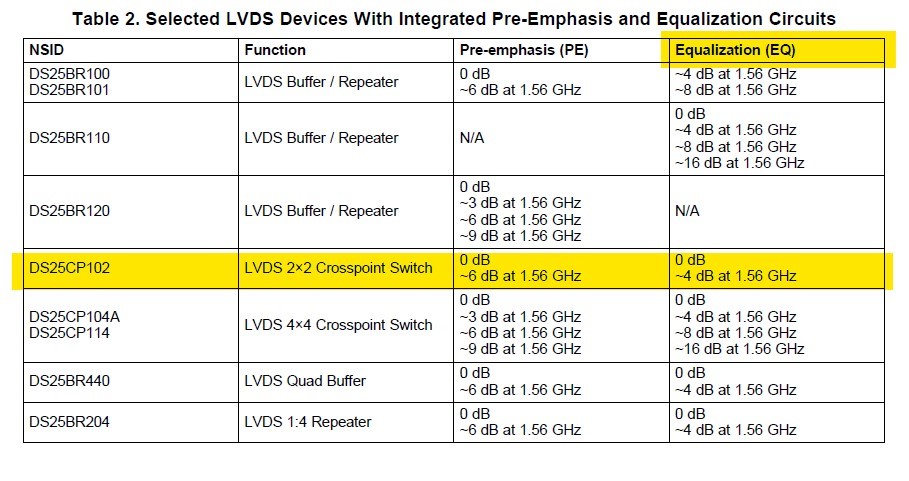

Only the light purple curve is available in the DS25CP102.
The low frequency gain is indeed flat. In the graphic the equalization curves are also showing a large voltage gain through the device. This is expected since the output drive is essentially a limiting amplifier. So the small signal input was output with significant voltage gain at all frequencies.
Lee

OK, so if I understand, your curves are the caracteristics of the whole component (from the input to the output with Pre-emphasis OFF).
I need to simulate the EQ stage to analyze the eye diagram between the EQ stage output and the 2x2 matrix input.
I assume that the first stage of the DS25CP102 is a CTLE equalizer.
So If I offset the purple curve to 0dB (@ LF), is it correct to extract the pole values and zero value of the EQ stage? (inspired by your Application note SLYT629)
Yes, using an offset to set the curve at 0dB for low frequencies is a reasonable approach to model to CTLE function.
