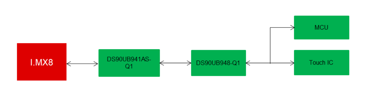

Hi team,
What is the difference pass through with pass through all of I2C? Thanks.

Hello Ansel,
Pass Through—This I2C control enables communication with all the remote devices, whose device ID
and corresponding device Alias fields is defined into the local device (Ser or Des).
Pass Through All— This control enables all I2C transaction over the serial link that are not addressing
Please check this AppNote. there you have all the details (Although it is talking about 913A/914A, but they are the same)
