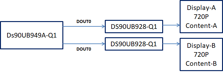

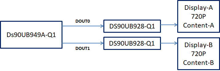

Hi team,
Can 949a + 2*928 do below application? If yes, could you provide the example script for testing? Thanks.
Cheers,
Alex
Hi team,
Cheers,
Alex
Hello Alex,
Yes, please see attached guide which is showing how to configure 947 for this. The same general steps are applicable for 949A.
e2e.ti.com/.../1374.947_5F00_Validation_5F00_Odd_5F00_Even_5F00_on_5F00_FPD3.pdf
Casey
