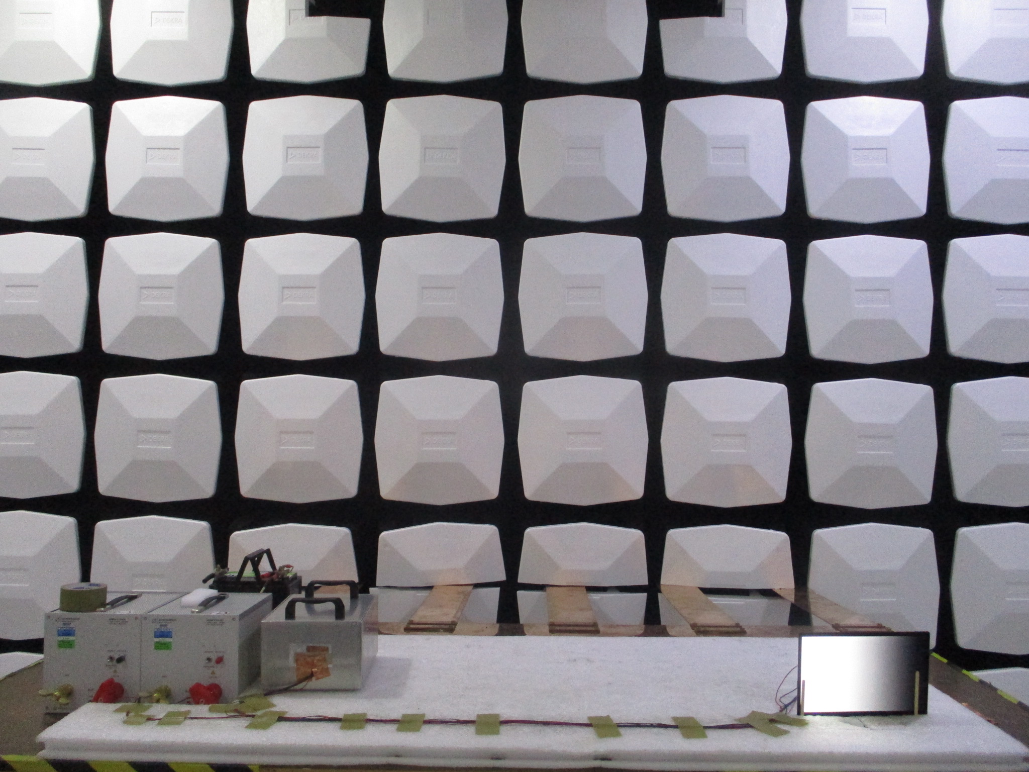

We have EMI test by using 947/948 and the result is showing as below.
STP/1920*1080_60frame(947 pattern gen)/PCLK=150MHz
RE310 frequency range : 45MHz-242MHz
We find that we have 101MHz and 172MHz noise on board, but we have no idea why 947/948 create these two noise, below is my condition
1. Only have 101MHz noise when 947(power on) and 948(shut down-close the power)
2. There is no noise of 101MHz/172MHz noise when 947(PDB pull low) and 948(shut down-close the power)
3. There are 101MHz/172MHz noise when 947(power on) and 948(power on)
4. There is no noise of 101MHz/172MHz noise when 947(PDB pull low) and 948(power on)
For above question, could you give me some comments?
And could you also let me know the difference between using PDB pull low and power off the serdes?
