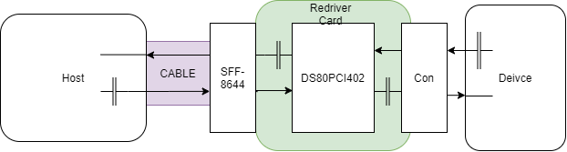

I have a question with ac coupling capacitors on PCIe.
The AC capacitors are currently placed as shown in the picture below, are these locations appropriate,
Please help and check, thank you!

Hi YiKai,
Yes these locations are correct. Normally AC coupling caps are placed on the transmitter side - same as what you have shown above.
