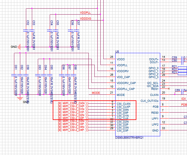

Hi TI Expert,
For a new project, Only 2 Lanes of MIPI are used. Do DS90UB953TRHBRQ1 and DS90UB954TRGZRQ1 are suitable for this application?
Are D0 and D1 channels used by default?

Hello Cyan,
yes, you can use only 2 lanes on one or on both devices. but you need to configure this correctly in register 0x33 for the 954, and register 0x02 in the 953.
Yes, if you use 2 lanes, then D0 and D1 + CLK0 will be used.
