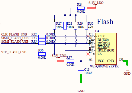

we have made a board that sinks 5V 3A and uses DP alternative mode with 4 lanes.
When we restart the PC, board shuts down as expected, but when the PC is starting back up again , the board doesn't start.
PC doesn't recognize the DP connection and the device stays powered down.
Can this be fixed with some settings in FW?

  • Okey , we have narrowed down the problem.
    It looks like , that , when you connect the device to a laptop, when restarting , it power cycles the device .
    But when the device is connected to a PC it doesn't power cycle the device , that's why it's not initializing correctly .
    Here is the project file : https://e2e.ti.com/cfs-file/__key/communityserver-discussions-components-files/138/5850.TPS65982_5F00_firmware.7z
    Here are the traces for a laptop and PC restarting : https://e2e.ti.com/cfs-file/__key/communityserver-discussions-components-files/138/restart_5F00_trace.7z
    The question is, how can I get the device to power cycle when PC is restarting ? And how to load the settings if its dead battery mode ?

    I checked the VBUS and CC lines , they do go down , VBUS goes down for about 400ms and CC one line goes down for about 400ms also and the other stays low all the time , probably because It's the polarity.
    Yes, we use the dead battery mode , with no VIN_3V3 voltage, so the device is powered from VBUS. BUSPOWERZ is connected to LDO_1V8D and SPI_MISO pin is pulled high to LDO_3V3.
    The fact is , that the board works , but when the PC is restarted , it doesn't initiate for some reason. But then connected to a laptop and It's restarted it works as expected.

    I captured VBUS, PP_HV, CC and SPI lines when PC is restarting, as you requested, as it looks like , TPS65982 does not reload the configs from flash memory on reset.
    Any ideas why?
    Captured rails : https://e2e.ti.com/cfs-file/__key/communityserver-discussions-components-files/138/TPS65982_5F00_rails.7z
  • Hi Eriks,
    Did you see LDO_3V3? Why SPI_MISO is low?
    The Apps. Config will start after it enables the PPHV sink path.
    How's PC differs from laptop when booting up? Did you see SPI transactions in laptop?
    I checked LDO_3V3 and It is fine. I don't understand why MISO is low also at the end of reading flash memory.

  • Hello ,
    I checked the 0x03 address and it returns "APP" , so that means its booting correctly and reading the flash memory without a problem as I understand.
    Your test with 2 EVM are faulty , because the EVM acts different from a PC and Laptop so you can't test the restarting scenario, also are the one EVM using my firmware version in dead battery mode?
    As I see in your captured scope , with my sent TPS65982 firmware version your SPI_MISO goes up at the end. Could this mean there is a hardware problem that doesn't let your SPI_MISO go up?
    All the pullup resistors for the flash memory for TPS65982 are 100k except for the SPI_MISO pin that is 10k , are they too weak ?

    It has been tested on multiple desktop PCs , it only works on laptop.
    I checked when the TPS65982 flash memory is reloaded , it looks like , when PC is restarting it power cycles the device and it reloads the settings , but when the laptop restarts , it doesn't reload the settings from flash memory, probably that's why the device works after laptop restart , the settings hasn't changed for it.
    Any ideas how to fix it , or what to check ?

    that's not exactly what I mean , the fact is that when I power up the device from laptop, it loads the settings from flash memory .
    I can see this with logic analyzer on SPI lines, but when i restart the laptop , nothing happens on the SPI lines.
    But in desktop PC case, I see that the TPS65982 loads settings from flash when i power up the device and when the PC restarts.
    It looks line the laptop only works after restart because It doesn't reload the configs from flash memory.
    Could it be something to do with that?
    Eriks
  • Hello ,
    After some tests I found that the values of pull-up resistors were too high for the flash memory.
    We swapped our 100k and 10k pull-ups for 2.67k (only ones we had on hand) and looking at the SPI lines the MISO pin stayed high after loading configs from flash memory. Then when the desktop PC was rebooted , TPS65982 started as it should.
    As I see it , TPS65982 didn't like that the MISO pin was low at restart.
