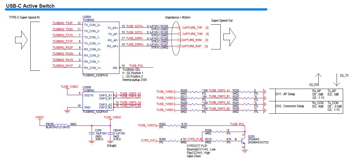

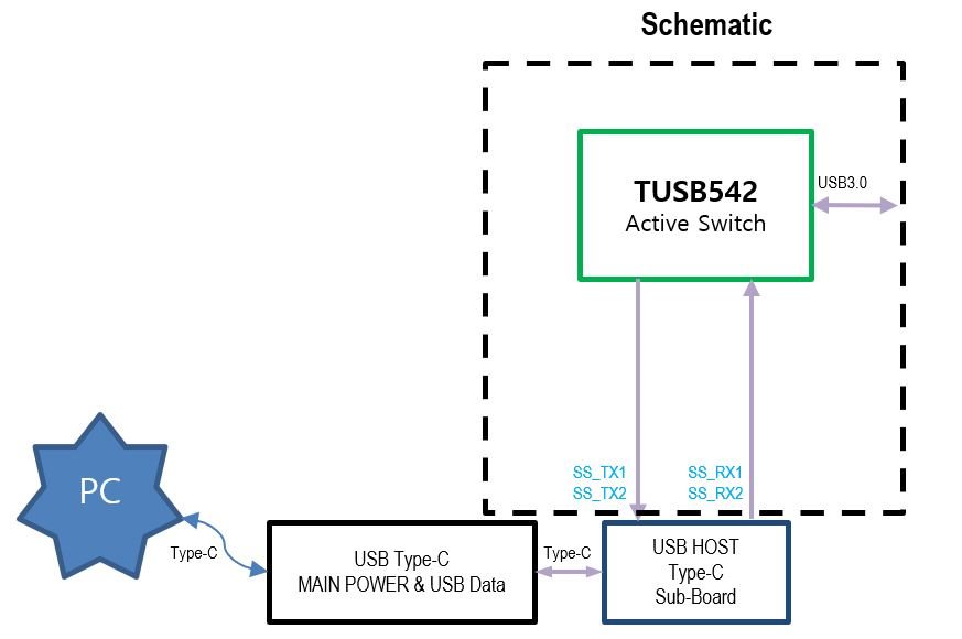

TUSB542: Request a Design review.
Part Number: TUSB542
Hello
Could you review the attached design file?
