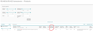

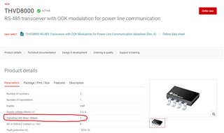

on the product page, it says max speed 1Mbps but in DS is only 0.5Mbps? which one is correct?
David.
David,
0.5Mbps with higher carrier frequency to data rate ratio, 1Mbps with lower ratio. Both are correct.
David,
0.5Mbps with higher carrier frequency to data rate ratio (more clocks in one bit), 1Mbps with lower ratio. Both are correct.
