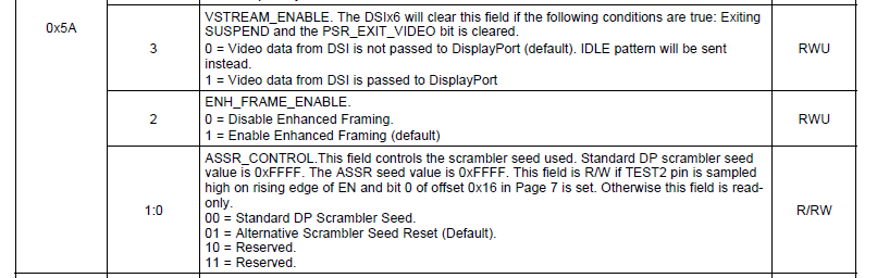

       I can driver my old LCD  panel,but can not driver the other new panel by sn65dsi86 ,because it have no ASSR funtion.How can i how to disable sn65dsi86 ASSR funtion?
       I try to disable the ASSR through pull up TEST2 pin to 1.8V ,but it can not change the 0x5A reg value . Please help me.thanks.
     Use attached script.  Make sure TEST2 pin is high at rising edge of EN.  This is described in the datasheet.

    Refer to ASSR_CONTROL register.
    Joel

    IS this must use mcu to control Test2 and EN pin?
    Oh,my god! I did not connect the two pins to mcu gpios.
  • e2e.ti.com/.../ASSR.png
    My datasheet have no this part,why? just mention “reserved”
