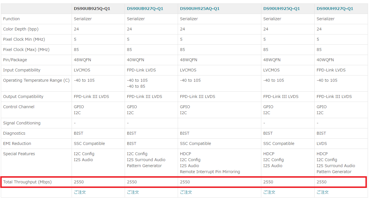

According to following web page, Total throughput of DS90UB925 is 2550 Mbps.
www.tij.co.jp/.../ds90ub925q-q1
I guess total throughput of DS90UB925 is 2975 (85MHz*35Bit/pclk) Mbps.
Does it typo?
Does it typo?

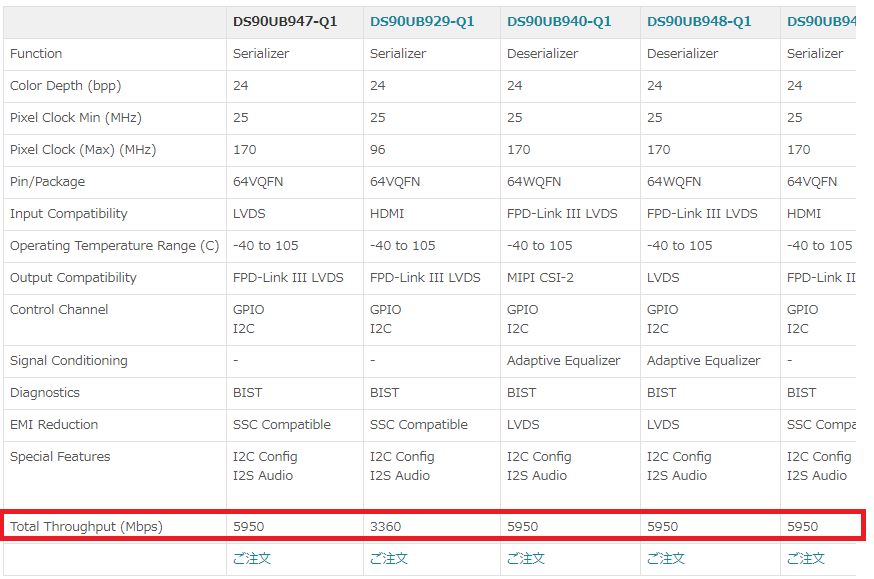

According to following DS90UB947 web page, Total throughput of DS90UB947 is 5950 Mbps.
This data is the actual line rate of DS90UB947.
DS90UB947 web page is displayed the actual line rate.
DS90UB925 web page is displayed the payload rate.
So, it is different from the display of DS90UB925 web page.
Which one is correct?
