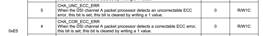

now the panel can't show ,but color bar mode is OK,
circuit: RK3399 -> SN65DSI83 -> 1024X600lvds panel;
read the register 0xE5 = 80;
if attach the scope probe to the data lane, there will be 2 error as the screenshot picture.
