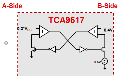

About the internal circuit of these devices, which do these devices have ’NMOS Series Switch type’ or ’Basic Structure of an NMOS/PMOS Parallel Switch type’?

    1) The TCA4311 is more like a series switch type, but has additional circuitry around it (rise time accelerators, precharge circuits, etc). Fundamentally, it is a series switch that connects both sides.
    The TCA9517 and TCA9517A have both sides isolated from each other, and use a parallel switch to ground to transmit 0s. See below simplified internal example of TCA9517[A]
    2) The difference between TCA9517 and TCA9517A is merely the difference between VOL and VIL on the B side. The TCA9517A has a smaller VOL-VIL range. Typically, we recommend that customers go to the TCA9517 (non-A) unless they see some issue where a slave is unable to pull voltage low enough to trip the B side comparator. The advantage is that the TCA9517 has a larger margin for noise, meaning less likely to get false 0s in some situations.

    3) "Weaker pulldown ability" means that the RON of the internal pull-down FET is higher than a 'normal' slave. THe result is that when a slave with a weaker pulldown ability tries to pull the bus low, instead of hitting 0V, the bus may only drop to 0.4V. This device adds another 50 mV to add some margin for slaves with the inability to pull the voltage below 0.4V.
    4) You are correct. The TCA9517A is not a bug fix. It is merely a slight spec change. We actually recommend that the TCA9517 non-A be used in most cases, unless you have a slave on the bus which is weak. The reason is that with a slightly lower VILC, the TCA9517 has a higher noise margin than the TCA9517A (if the voltage bounces between VILC and VOL).
