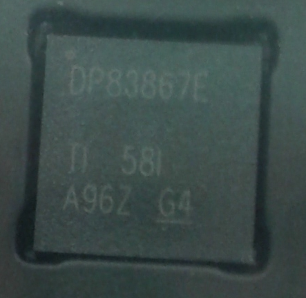

  • Abdulkerim,
    Are you using DP83867 devices you procured from the estore? This part is relatively new and I want to make sure you have the production devices. Can you send a picture of the top marking of the DP83867 device you are using?
  • Hi Rob,
    The device we are using is a sample. Please find the picture of the top marking below.
    If we didn't interpret it wrong, the top marking reads as:
    DP83867E TI 58I A96Z G4
    Abdulkerim
